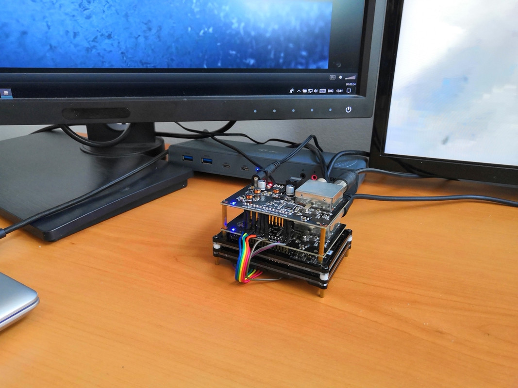

Khadas VIM2 cu tuner dublu S912 cateva imagini

Este exact aceasi combinatie doar ca in loc sa fie conectat cu 8 sarme
(paralel este conectat cu una (serial) de aia se si pot conecta 2 tunere.
asa arata placa.
Aici se vede cum este conectata si se observa ca sunt patru pini: D0,clock, sincronizare si confirmare de acord lock led mai este si magistrala I2C 2 pini.
Practic daca as avea acces la cei 8 pini paraleli din VIM2 cu orice tuner de K1,K2,KIII ar merge perfect sunt toate la fel.
10 Apr 2019, 21:35

Ai aici o explicatie mai in detaliu:
Finally this week arrived VIM2 + VTV.
I started work to adopt AVL6862 driver to support VTV board.
Current driver support Mecool K-series devices. The main differences between Mecool and Khadas is how is AVL6862 demodulator connected to S912 hw demuxer. Mecool use parallel connection (8 bits) vs. Khadas serial.
Current open source AVL6862 driver by Luis Alves supports only parallel transfer.
Task to do:
Modify device tree blob to serial connection and support lock led;
*Add serial support to AVL6862 driver;
Update amlogic modules aml_dvb and aml_dmx to accept serial data from demodulator
Work is in progress. The first two step are almost done.
Astia se ocupa cu driverul.
https://github.com/CoreELEC/linux-amlog ... ic/dvb-avl
11 Apr 2019, 08:23
